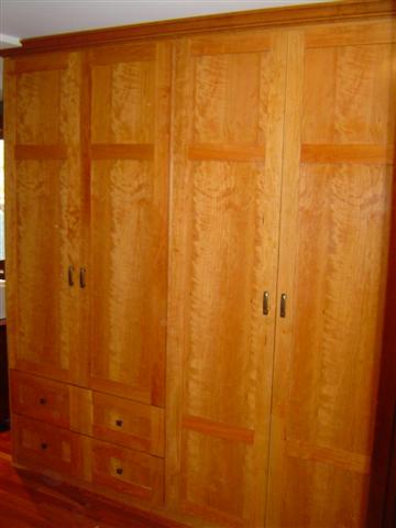

Welcome aboard Hogan. I recently finished this set of cherry closets and used the following recipe: Two coats of boiled Linseed oil, two coats of garnet shellac, and two coats of wipe on poly, followed by two coats of wax applied with steel wool. Keep in mind that this was a closet and not an instrument so I wasn't worried about oil penetration into the wood affecting the sound. You might consider a seal coat of shellac before the oil to minimize prenetration. Test on some scrap first to get things right and good luck.

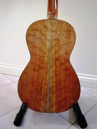

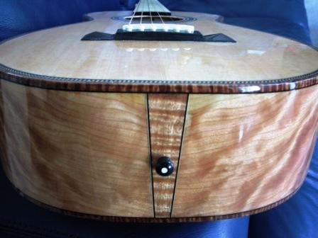

I finished a parlor guitar in KTM-9 and was very pleased with the results. Even though it is a non-porous wood, I applied several coats of Zpoxy and sanded between each coat. It seems to really pop the figure in the wood. I then applied a light coat of shellac before spraying with KTM-9.
Here are a few pics of the finished guitar. This is some of The Zootman's finest wood I've ever seen.

Robbie... Great looking cabinets
JJ Sweet guitar my friend!
Hogan.. I'd stick with KTM9 if it was me. It is pretty easy to use, durable and looks great. But then I've never tried oil.

The more I look at your guitar the more I like it. What is the B&S wood? And how about the binding? Also, did you put a little amber in the KTM9? I don't see any blue at all.

Joe the wood is curly cherry.

Joe...The binding as well as the butt wedge is Eucalyptus...also from The Zootman.
No tint. I was very pleased with the natural color of KTM-9. No bluish cast whatsoever. I also used it on walnut with no hint of blue.
Alain...That guitar was made for my brother. I visited him last week in Texas and was astounded with the sound...actually sounds much bigger than a parlor guitar. BTW, the finish still looks great and the cherry wood is taking on a reddish patina after a year. It seems to be aging well. I'll definitely use cherry again.
